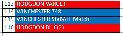

I have a lightweight 20" Savage 6.5CM that used W748 to get 85gr Hammer Hunters to 3402 fps. I didn't like the temp instability I was seeing....hard bolt lift over 70*.
I did load development with Winchester's StaBall MATCH since they are side by side on burn rate charts. It used more powder (from 44.0gr to 46.5gr) but MATCH gave me 3431 fps and no issues with temperatures.
Just something to think about.
