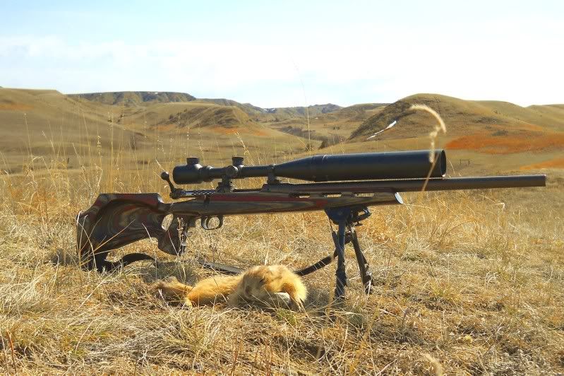

My 20VT with a victim :)
Accuracy of 5 shots at 100 yards using Ramshot X-Terminator, Rem 221 FB brass, and Fed 205 primers.
IMPORTANT NOTE:: If you build a 20 VT, do not use 17 FB brass. The necks get too weak when enlarged to 20 cal and will crack during sizing or after minimal firings. Be sure to buy 221 FB brass. Take Care!

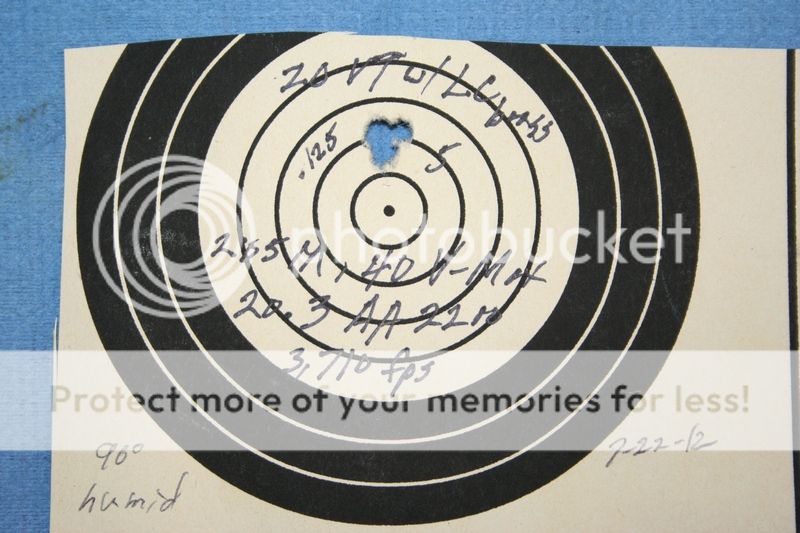

I make my own brass from Virgin LC 223 and to say it's 1000x's better is just a start. In a well made firearm like Stiller or a fully worked over Remington (bushed pin)you can obtain useable speed and accuracy only dreamt about.
In my rifle I run AA2200 with a 32gr VMax @ 4100fps and this type of accuracy.
In fact in my rifle 4100fps and these groups (right side) are very common. I use a CCI 450 primer also.
This is also coming from a 22" barrel. I have shot these cases (4100fps) 9 times now with lots of life left in them.
Just something to think about when going down this road, a little of your time making cases and the reward is life long brass. Adam

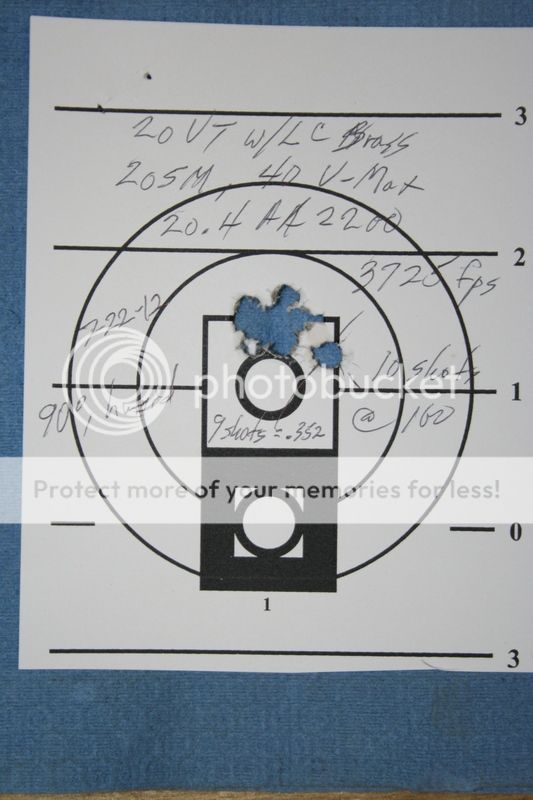

Here is a picture of what AA2200 and a 40gr Vmax does using LC Brass. 3750fps and accuracy to boot. Adam
