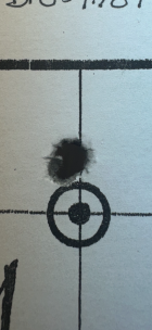

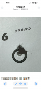

I got this guy around 200 yds using a Berger 90 grain boat tail Target bullet that the hollow point had been opened up. I tested the bullets at 100 yds and they shot very nice small, one hole groups. They did an outstanding job on this GH. At 200 yards. The bullet blew the back side of the GH up to say the least. Massive devastation. Now I need to test at 300 yards and beyond if I can find a volunteer.
6mm BR
1-10 twist
6x25 Leupold
I have a bunch of the 90 gr. I did try some of the 88 grains earlier in my reloading days. I never got them to shoot as good as these 90. When I put a dent in the 90's I may go back and try again with the 88,s. It's not that I think I am a master reloader to have got the results out of the 90,s . I think it is the theory a bling squirrel finds a nut ever now and then.

the 87 grain Vmax are most definitely explosive! That is the bullet I have shot for a few years. You hit the key word here. Repeatable accuracy. For what ever reason I can get batch to shoot nice little one hole groups. Next batch I load looks like I shot a shot gun at the target. So I was just working up loads for different bullets. My buddy gave me a bunch of the Berger 90's and right off the bat I lucked into an outstanding load. I tested numerous times and with very very good results every time. So I put the 87's up for a while.
I'm not a high bc end all, be all guy but I bet that big hollow point does a number on it. Good shooting, those are some impressive groups.
Aaron
I would estimate you are correct. Most of my GH shots are between 200-350 yards. I'm trying to get beyond 387 yards. That's my longest kill with the 87 v max. I'm going to try to do some testing with the hollow pointed bullets this fall and winter to check the bc. Thanks for the compliment I'm tickled to death with the results with this gun bullet combo. I have a bunch more groups with that bullet just like those I posted. I figured 4 would be enough to show why I am liking the 90 Bergers. I also have some custom Bullets my gun loves but I'm definitely being stingy with those.
