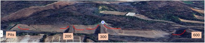

Yep, this hold up at the range I shoot at as well, but only for left and right winds. For head and tail winds, it isn't so straight forward. Our shooting positions on the course (200, 300, and 600 yards) are elevated berms and most of the time, both head and tail winds actually raise POI because of updrafts created by the face of the berms. Very difficult to read. The goal is to just find a common condition before pulling the trigger.
