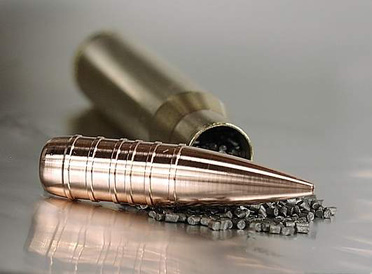

Here is a thread on another site that did just that. They made bullets in .001 incriments from .300 to .315 and shot them.

Thank you for the link Kmart. I read it all the way through. I noticed one thing and some one points this out in the end of the thread. The body of his bullets were never made big enough to touch the grooves of his rifle. Only the bands on the bullet were enlarged. Would this affect the test. Those bands on the bullet are rather thin and I would thing they would just get shaved off?
His revelation about how shooting a smaller bullets was also very interesting. To think he did not see any key holing till he hit .302 and he says that at .305 which is 3 thousandths smaller he saw no degradation in performance except for a small drop in muzzle velocity.
