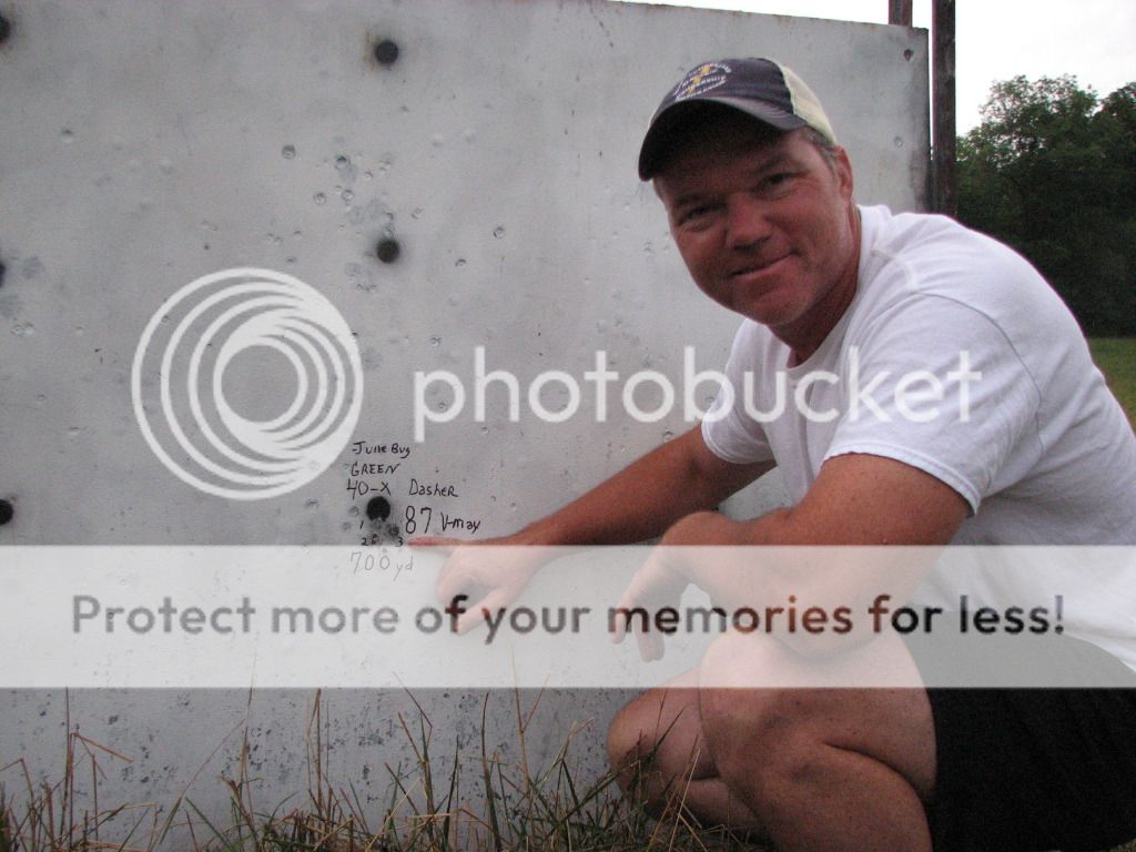

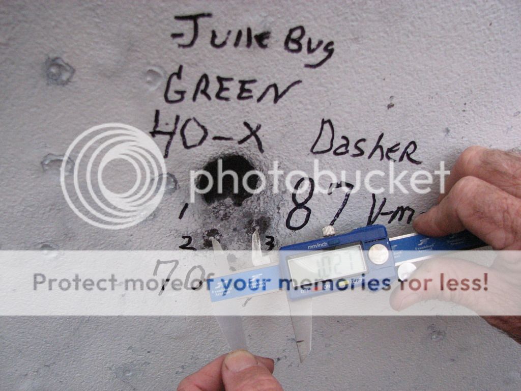

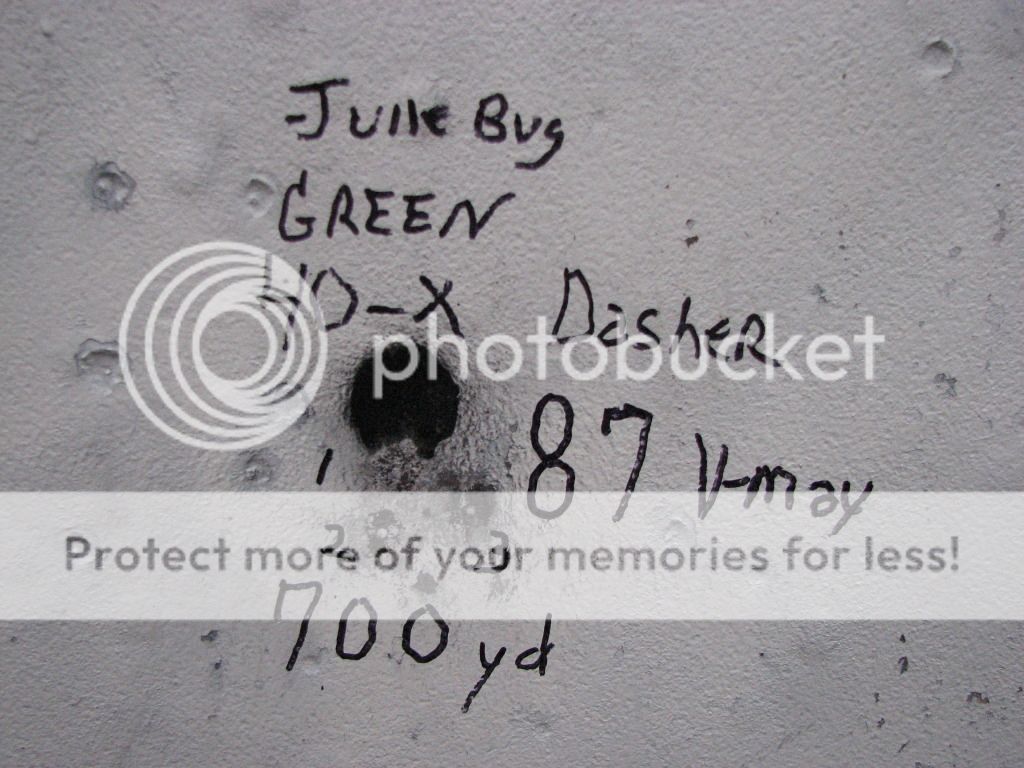

12 twist Lilja 40-XBR Dasher
87 V-max
Shooter--Junebug
700 yd

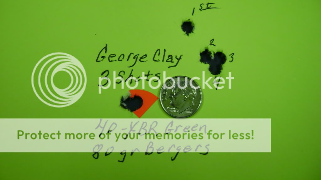

same 12 twist barrel with 80 gr Bergers
George Clay shooter

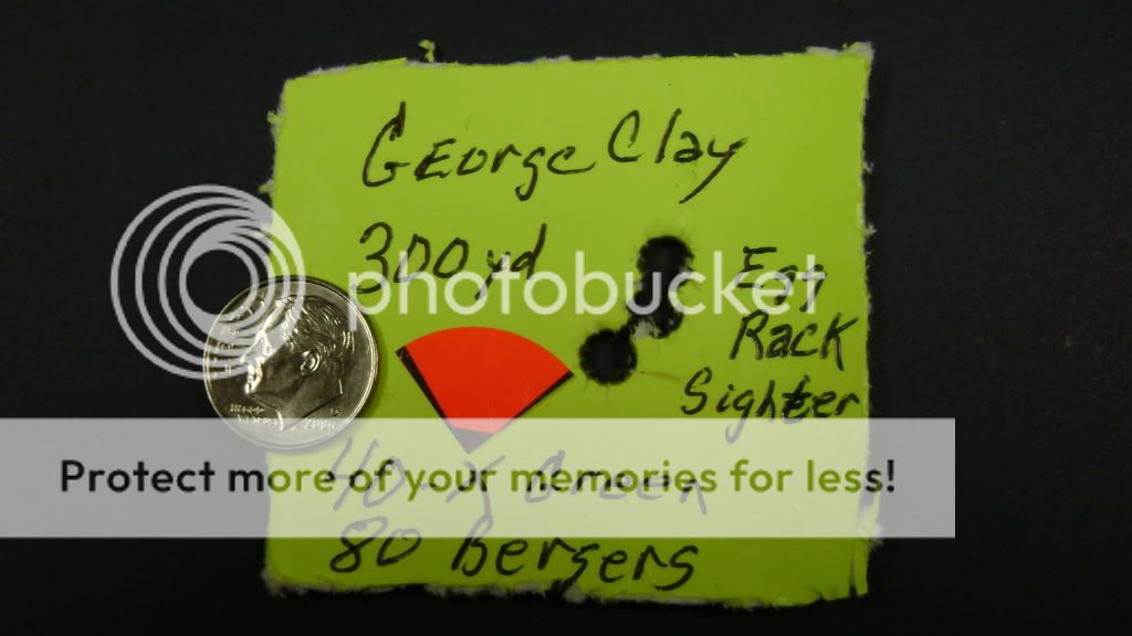

300 yd----80 gr Berger

If you look at the first pictures Birdog posted in this thread those groups were at 700 yards.....
They look pretty good to me. 8)
