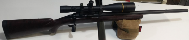

Russell,
We need pics of this beautiful rifle of yours! Needing some motivation for the next build. Lol!
Paul
