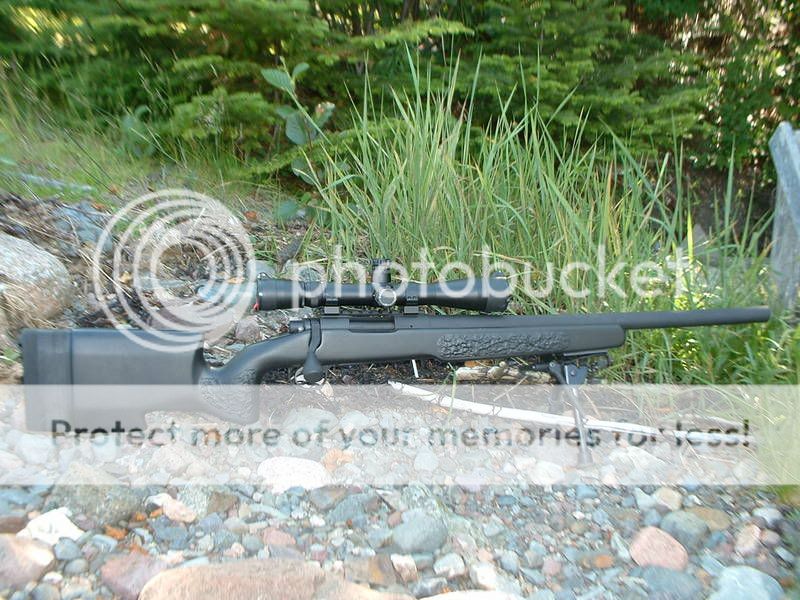

I built the .223 to shoot heavies. 22" 1-8" L-W tube, trued 700, Manners stock. Nice long throat. Now I've got 80 gr. bullets in Vmax, JLK, and Berger flavours, N540, R15, Varget, and N150, and Fed. 205, CCI 450 primers. Anybody care to help with a good starting point? I've got a pile of weight sorted W-W cases, and a day to spend at the range w/ the portable loading box, so lets hear it.
