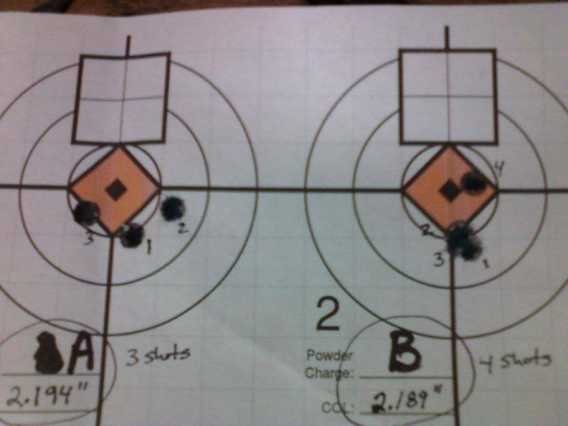

Got around to playing with seating depth, and looks like I found a real good sweet spot. Thanks for all the help and pointers. Load Chrony around 2960 avg with 24" barrel.
settled on 58.4 grs H4350 as OCW
A= 2967 fps / .070" off lands
B= 2958 fps / .075" " "
