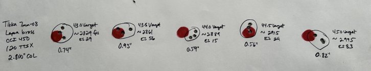

You have a different username here. Here’s how the 120 ttsx did in mine. I was just testing more for speed and pressure with the little range time I had so I didn’t really take my time shooting. 44.5 gr felt good and I know it can be better because by that time the barrel was warming up and I didn’t let it cool.

I tried the 120 TTSX but the gun just would not shoot them. (You just traded with me for some of the leftovers!) I had thought about testing them again with different powder but the gun loves the 140 TSX and the 150 Gamekings.
i also tried the 120 TTSX .I have 4 guns in 708 .only the encore likes them
Glad to see they are working for you! The 120 TTSX is a great bullet.
