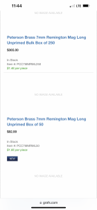

I’ve had and have been Reloading a 7mm Remington Magnum for years and now looking for Peterson brass checked Graffiti and Sons they have some but they have 2 listed one is 7mm Remington Magnum and another is 7mm Remington Magnum long brass . Can some one enlighten me to 7mm Remington Magnum long brass this is the first time I’ve heard of this

The Long brass shoulder is much closer to the chamber shoulder though they still headspace to the belt. Their original long brass were the 300WM, they just adapter the concept to the 7RM.
Get the long version.
