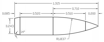

I'm attaching a 2d drawing of the Nosler ballistic tip. My measurements vary a little from yours.
