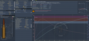

Looks like a perfect fit in this simulation. 101% case fill, 100% burn. I'd definitely take it for a test drive

That GRT simulation is using the SAAMI 7mm PRC case, not the 7-6.5 PRC. The 7mm PRC's default case capacity is 82 gr. of water, and my Lapua formed 7-6.5 PRC brass has a measured case capacity of 69.35 gr. of water. As you can see, two very different animals. I don't think it's possible to get 70 gr. of H1000 in a 7-6.5 case.

Good catch, didnt notice that
