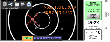

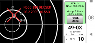

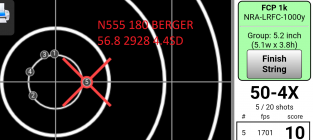

Here is some data during testing. We find that this "dasher" length neck is providing excellent SD results so far across multiple powders and bullets and primers.
