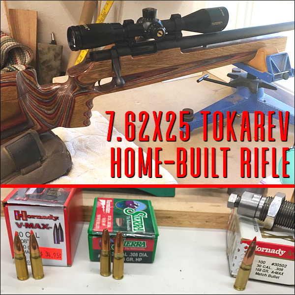

Well today I took my7.62x25 rifle down to the shop to try to work up some loads for it. I was searching for some load data for it with heavy bullets and came across an old post on this forum that said western powders had some data for this cartridge in the AR-15. I sent them an email and the next day load data for bullets up to 200 gr. showed up in my inbox. It said it wasn't lab tested but should be a good guideline. I ran them through quickload and they looked ok so I loaded some up and punched some holes in paper. The 168 gr. Berger moly LTB didn't do as well as the 168 gr A-max so I started working with that. I'm loaded really long and the tokerov evidently has a pretty long freebore but i managed to get it into the lands. This is the best this gun has ever shot. I've gotten mostly 2 inch groups at 50 yds. (max home range) Today I made some progress My best group was a little less than 1/2 inch after the wind kicked up.

My empty brass looked good, primers looked ok. the hottest load was the best . I can go up a little as I'm not at max on the recomended data. I'll probably set up my chrony tomorrow and see how things look . I'm at about 1400 to 1450 fps. I'd really like to lob those into one hole.

Once upon a time I got this idea to make a bolt action with front locking lugs, full diameter bolt, remington trigger. It took me years to get it all figured out and make all the tooling then it took about 6 months to build the gun . I made the action, profiled threaded and chambered the barrel. I made the stock from a laminated blank. It looks different but I like things that are different not the norm. I wish the 7.62x25 had a longer neck . At .140 thou it's pretty short, I think longer would help getting things lined up better, boat tailed bullets seem to load easier than flat base.
Even if I cant get it to shoot one hole groups it still turns heads at the range.
