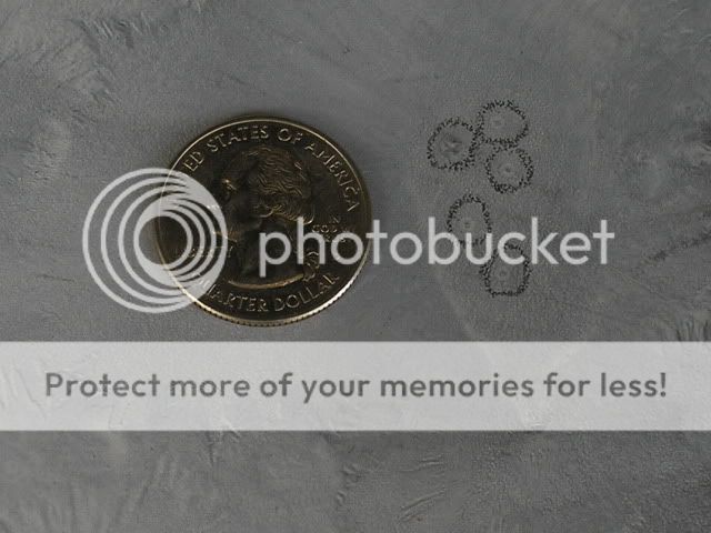

This group I shot last fall @ 400 to verify it was on. It is shooting the first XC I built with a Rock barreled rig.The second one with Stiller/Krieger @ 24" I shoot the same load but naked 107's. 17 3shot groups with Norma brass and 5 different charge weights of H4350 from 39.7 to 41.5gr averaged .496". So 51 shots under .5 is pretty decent IMO! I just haven't gotten around to switching scopes and shooting it at distance etc.
I sprayed the target so the circles from the 107's my brother uniformed the tips on showed better. All right behind the shoulder exactly where I intended for them to be. Even a senile old cripple gets lucky occasionally. :)
