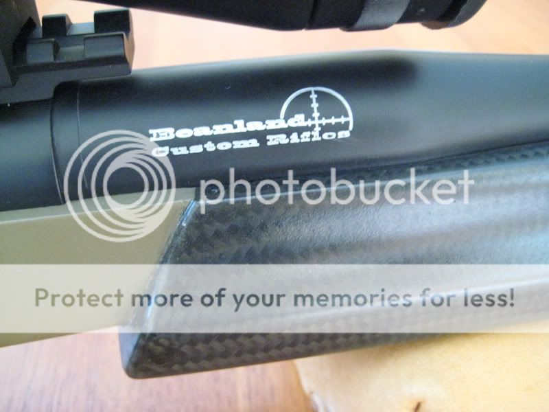

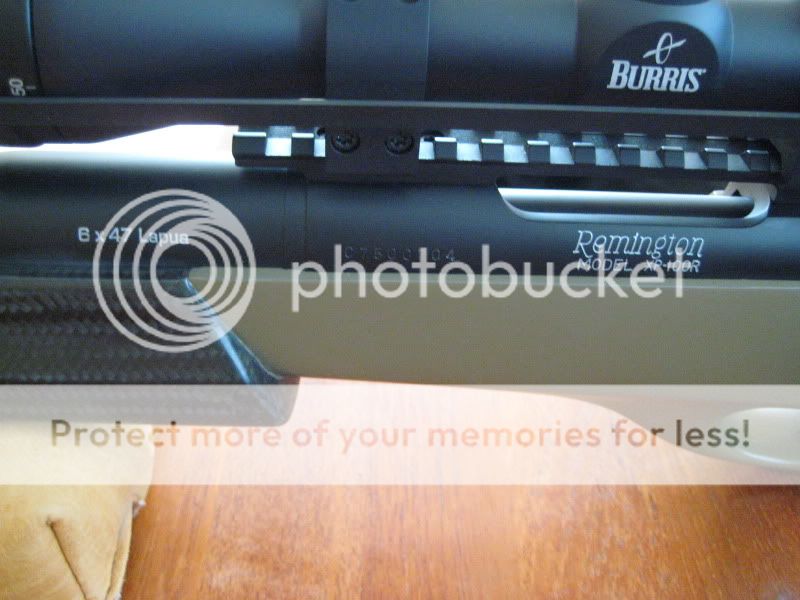

At 100 yards off a leather rear bag and my NEO rest. Factory trigger is about 3 lbs. I'll be swapping a 4oz Jewell into this gun before the next range session.
Left was the 70 gr SBK with H-4895 and the right was the 75 gr v-max with H-4350. The gun doesn't even shift off the target backer with these light bullets. Can't wait to unleash this thing on a Pdog town.
