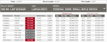

All of the same powders they show for the 6mm Creedmoor using that same bullet are good candidates for the x47 brass.

You can find a Hodgdon listing that also shows powders like 4064 and 4831 for the 105 Scenar bullet, so all of these are good candidates too.
Sierra is showing N540 as their accuracy load at 2800 FPS with the 107. They also have data for the hybrid 100V powder.
