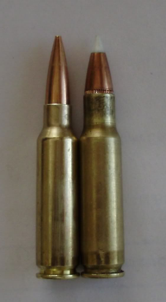

6x41ARP(6.8SPC necked dn to 6mm) allows 95smk from mag
The goal was to be able to use the 95 SMK from the mag, case shortened to 1. 50, bottom of the shoulder held at same location but changed to 30 degree. 3000fps from a 28" barrel with 5 different powders looks pretty good. It's a match chamber for now with a .276 no turn neck using SSA small primer 6.8 brass.
6x41 on left, 6.8 on rt
ETA-Just to keep the hackles down, it was not intended to be a new HP or BR cartridge just something that will shoot longer 6mm bullets from the mag and feed well from standard high capacity PRI 6.8 mags with no fireforming required. hunting, varmint, tactical or whatever. I started with a 28" that will be cut off in 2" increments to determine the most efficient or practical length for whatever use. The best thing about America, the right to choose.
