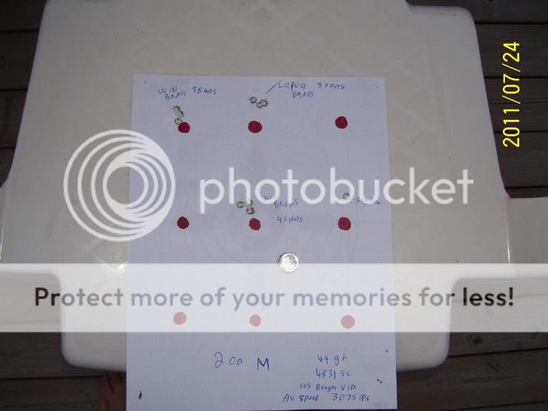

Hi guys I just chambered an slr about a week and a half ago and am doing some load development , I had some surplus powder made by nobel called 47N which is a 4350 type pwder I shot some beautifull little groups @100 fireforming.
Yesterday I tried some H4831 sc 44gr with 105 berger vld gave me an average speed of 3075 fps using lapua brass ,I tried win and rem brass also with the lapua giving less vertical by the looks of it.
This is a target I shot yesterday at 200m
Julien......nice 200 metre target for a new barrel. I am making up my mind between H4350 and H4831sc with the 107SMK. Loading to 3050 fps with both and getting good accuracy.

Next time out I was thinking of trying a slower powder I would like more speed out of 105 or 108's maybe some h1000 or some retumbo , seems to me I am at about max pressure with 44gr of 4831.
The 105 bergers I was shooting were jammed in about 7-10 thous the first time I shot it I had not measured the bullet to the lands as I was just fireforming I measured the lenght to ogive were a good .035" jump and they shot great.
Yesterday I only got it to group well when the bullets were jammed a bit I may try them again with a good jump like the first time.
