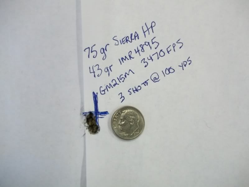

In a 24" barrel my 6mm launches the 75gr Sierras at 3470 fps and would probably do a little more if I pushed it. My twist won't allow anything higher than about a 87gr V-Max. Phots are just of initial 3 shot testing. It will print 5 shots into a similar group.
43gr IMR 4895
