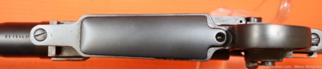

As I was searching gunbroker for actions, I stumbled onto a receiver/barrel combo for 6mm Krag built on a P14. Obviously, I bought it so I could see the details of it was built and if it functions properly. I was pleasantly surprised to see it looks pretty well built, and it appears to never been used after the built.

Thanks. Here are some of the pics of the P14 I bought, and one of the cartridge specs.

The barrel says nothing about Ackley like your drawing does. Could it be just a plain old 6mm Krag? It might be best to get a chamber cast done to be sure exactly what you have. Brownell's sells the stuff. If you aren't comfortable doing it yourself, a good gunsmith should be able to do it for you.

As noted, you need to get a chamber cast to see what you actually have, after you gather your stuff together you should be able to use 243 loading data ….Within reason. The 30US or 30-40 K has effectively the same capacity as a 308, which is the base case for the 243.

There was a Norwegian 6.5x55 Krag, but no 6mm Krag produced. Only thing I found was Ackley's design for the 6mm. Whoever installed the custom barrel marked it. A barrel cast would probably be best. I appreciate the idea and link.
