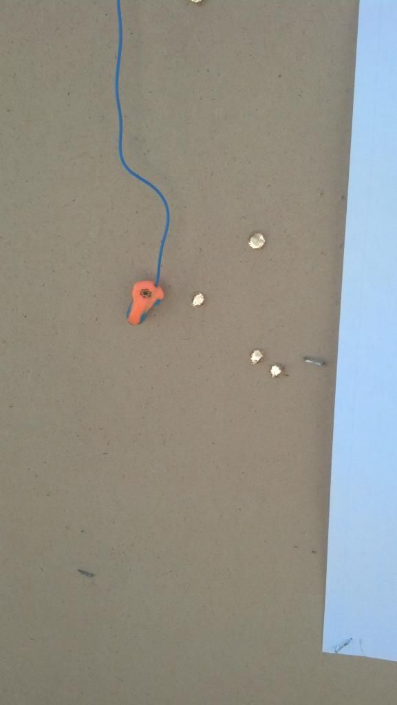

Attribute its accuracy to luck, day of the week it was chambered, by the way the builder was John Holliger, but whatever it was the gun and loads shoot exceedingly well.
*NOTE: Performance occurred in NW Louisiana for Density Altitude and atmospheric reference
Hey Casey,
Did you only shoot two shot groups at 600. Are those 87s 105s or some of each. Judging by your thumb nail, those are crazy groups for 600. They look to be sub 1/4 min groups....is that correct?
