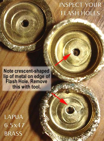

I wouldn't bother to uniform the primer pockets. Truly. Re the Flash holes -- inspect them and decide what to do. Personally, I would not ream them, but I would remove any obstructions or flakes of brass you see in the flash holes.
Check the Bulletin re recent Lapua Brass. You can use an inexpensive pin vise to knock out any little brass flakes that are blocking the flash-hole.
INFO: http://accurateshooter.wordpress.com/2007/03/30/brppc-flash-hole-deburring-tips/
