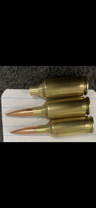

Here’s something some guys may be interested in. I just finished a project. I’m a fan of the 243wssm case. I ordered a reamer and had whidden make the dies. It’s a 243wssm blown forward about.080” and a 35* shoulder. Necks are turned down too .015” wall. An 8tw Krieger at 28”, I slowed the Berger 105vldh down to 3,370 fps. N540 at 41.5 gr. I saw 45.5 gr push them 3,580 but started getting slight ejector marks on the brass. Found a lower node at the mid 3,300 and went with that to save on brass wear.
If anyone would like anymore info about this, I’d be glad to share about the build
