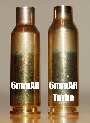

I'm a big fan of the Turbo 40. I've shot over 9000 rounds of it in NRA OTC competition, with a bit of Mid Range Prone mixed in as well. For that type of shooting, I think it's pretty tough to beat. Not sure if you are into that sort of thing, but since you mention owning a Tubb, I'm guessing maybe so? You also mention the Tubb having a brake, so maybe not? Anyways, it is absolutely reliable in the AR15 platform, and the only time I've ever had issues with mine was a couple of years ago at Camp Perry when I got caught in a downpour and literally had to pour the water out of my rifle prior to shooting. The biggest advantage over the 6.8 case is that you are able to load 105-107 class bullets to mag length, if that is a concern for you. Grendel brass is more expensive than 6.8, but the Lapua stuff is excellent, and should last a while if you don't abuse it. The first season I shot mine, I was loading 30.1 grains of Varget. It was very accurate, but was wearing out brass very quickly, like 2-3 firings and primer pockets were toast. I've since backed it down to 28.5 for 95 SMK's and 29.0 for 105's and the accuracy is just as good, just a little slower. That charge gets me right around 2780 fps with the 105's. I don't feel like I am giving anything up to the bigger dogs at 600 yards and in, and I have shot a lot of clean 200's with it at 600. I've shot it in a few 1000 yard matches also, and it'll do ok if the wind isn't blowing too hard. It doesn't real have the speed to keep up with the big guys if the conditions aren't good though.

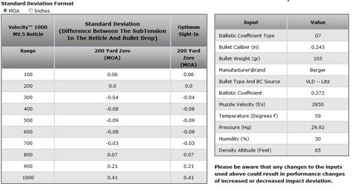

I like to use NF Velocity reticles for enhanced speed in the field if you can get a load to match up well. When you can work up a load to fit the scope you trade off some performance sometimes but gain a lot of predictability. Of course, if the rifle didn't want to shoot there i'd have to make other adjustments lol. Thankfully with my 260 AI it matched up perfectly and adjusting for higher or lower DA is not hard at all past 800 yds.
This image is of a 105 hybrid at 2850. Since it's an AR the sight height will be different and I haven't gone through that yet to see how much difference it will make.
This combo won't be as impervious to environmental changes as my 140 hybrid @ 3050 fps setup but with the high-ish BC of the 105 hybrid it should still be better than most loads and way more enjoyable to shoot.

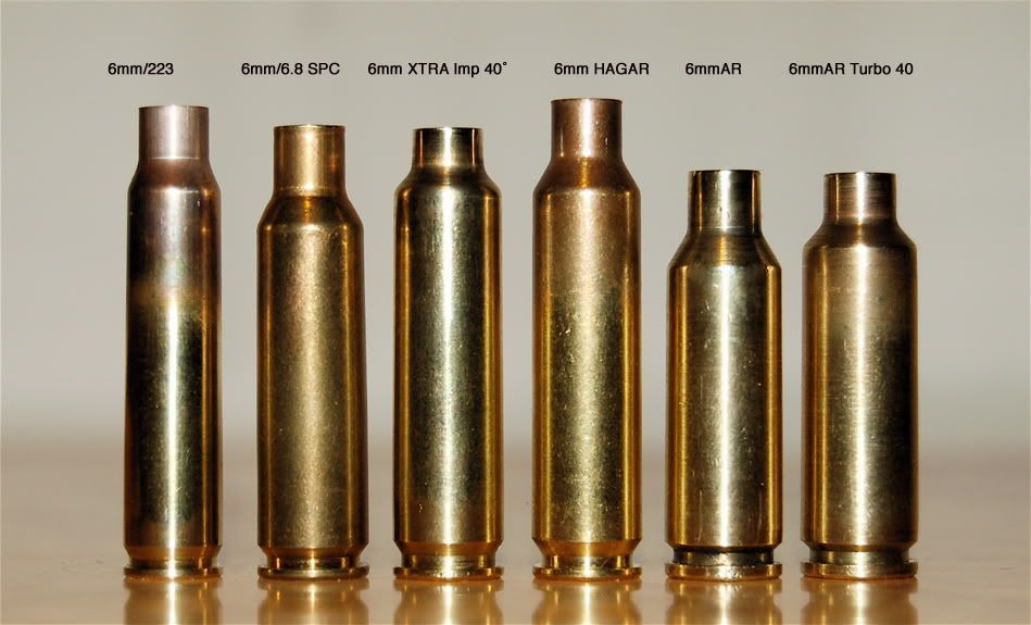

Range reports in my neck of the woods has the AR-15 guys staying away from the AI or 40° necks for feeding "pickyness." I'd put a lot of thought into 6mm HAGAR though if you want an AR platform cartridge.
Bolt rifle, I'd make other choices than 6.5 CM. If you are looking for your first AR platform, it really depends on AR-10 or AR-15. AR-10 is non-standard, there are several styles and be careful, not all parts are exchangeable. AR-15 is easier, and that is what the 6mmAR is for.

I've read a lot of stuff like this on the internet, but have never seen it in real life. I've found no signs of this "pickyness" in my 9k rounds of first-hand experience with this cartridge. I have 3 other competitive shooters in my area also shooting this round, and I'd bet that between the 4 of us we have shot in excess of 20,000 rounds of 6mm Turbo 40. It isn't picky. I have 8 C-Products magazines that I use at every single Highpower match I shoot, and they all work perfectly.
Good to know the cartridge is sound, I'm guessing it depends on the smith/assembler then. As with any wildcat your experience may differ.

I had a 28" MR upper in 6 RAT for a season, and never had a single feeding issue with it. Far as I'm concerned, the only downside to the RAT/FAT RAT/40* Turbo is bolt lug breakage when the owner tries to push 105s too fast. We always used LMT Enhanced bolts in our RATs and never had a lug break - but I don't believe LMT makes them anymore.
The source for Hornady 6 HAGAR brass has dried up - Hornady has no interest in commercializing the HAGAR, nor in making another run of the brass. That's more or less from the horse's mouth, coming from the guys who were distributing the HAGAR brass.

Your loads, velocities, and observations on case life are pretty much spot on with my experience. I started out at 30.3 gr of Varget with 105 gr Amax's and was losing primer pockets after about 4 - 5 firings. Now running with 29.6 gr Varget and a little bit more jump and haven't lost a primer pocket since, but brass still comes out looking a little beat up.
