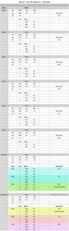

I have a 26" 6GT but my barrel is a 6-groove (PVA Osprey) 7.5 twist. I'm not pushing hard as this was a new barrel. Below is some testing for Staball 6.5. with the 109 ELDM's
Not an ideal powder for it, but I have three 8 lbr's

In your graphic, the last 2 show a COAL difference of .001" but your jam value changes by .010".
2.264 vs 2.265
.010" Jam vs .020" Jam
Typo I'm sure! May have used copy and paste for formatting and it may have incremented?
Scratch that!! I just went back and looked ... should be 2.600, 2.640 and 2.650 OAL's. I'll edit the previous post and fix the attachments ... apologies!
