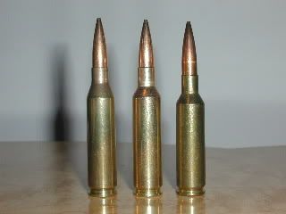

A lot of people are wondering what the 6CM case looks like, so here's a picture of a 243 Win,left) vs Joe Hendricks 6CM,center) vs a 6mm Super X,right).
Robert Whitley
My original understanding was the 6CM had the shoulder pushed back 0.100" as well...the pics doesnt appear that way :confused:
JB
The 6CM shoulder angle is actually 31 degrees - much steeper would not be so good for rapid fire feeding out of magazines. The shoulder is not bumped back, and it's like an Ackley type case where there is a slight jam fit with 243 Win brass when loaded into the chamber, and when fired things fire form from there. The beauty is no forming of brass up front - just load up 243 Win brass, stick it in the chamber and pull the trigger and your brass is made! You can shoot the new 243 Win brass for short lines, practice, etc.

Sure makes me wonder what all the fuss is about.
A 243 with a 30-degree shoulder,35??) it looks like.
I never claimed it to be much more than that. However, it is not a 243 with a 31 degree shoulder.
If you look closely at the picture you will see that both the neck and body are longer than the parent 243 Win.
Longer neck for added accuracy and longer body for added case capacity.
Joe Hendricks
Well of course the body is longer, but the neck? by how much? Will a strait 243 case still headspace off the shoulder when inserted in the improved chamber or does the shoulder need to be set back first? It does'nt appear from the pic that the shoulder is set back at all. How does it grow when fireformed? It should shorten up...

OK, so it's a 31 Degree 243 Ackley. Ackley hisself did the 30 degree and Warren Page did the 35 degree, both with the same results.
An Ackley chamber is a crush fit with factory ammo and .004" short chamber headspace. Much more than that and closing the bolt becomes problematic so I can't really see where neck length can be increased very much beyond that. ,Remember the 220 Wilson/Woytkins Arrow that used the same principal but required that the factory case be reformed before it could be chambered?)
But Joe, all that aside, I seriously question your statement above that claims "longer neck for added accuracy". How did you arrive at that conclusion? Recent experiments by a couple of score shooters seem to contradict that,30 Wolf Pup).
Ain't wildcatting fun?
Ray:D
Joe
It looks like I stirred up a hornets nest by posting the photo showing the 6CM. I still think the cartridge is neat and I can't wait to try it out. To me it does not matter whether Ackley or someone else may have dabbled with a similar case design, where did they ever go with it? Measuring things up, the 6CM clearly has a longer neck and a longer body than the 243Win and I don't know why people have such a hard time accepting the fact that that might be possible.

This is no Ackley. Ackley improved his cartridges by straighting the wall of the case and then blowing the shoulder out to what ever degree he chose.
This is a cartridge designed for shooting XTC competition. It transfers well to F Class, and other long range applications, but make no mistake it was made for winning the XTC Camp Perry Championship. It feeds well, because I kept the taper in the body and it shoots unbelievably great.
Does a longer neck make a difference...I don't know. At the time that I was developing the cartridge the consciouses amongst bench rest shooters was that a longer neck added accuracy. I don't know if it does or not.
All I can tell you is that this is the best cartridge I have ever shot at 600 yards. It seems to be inside of every shooter I shoot beside.
Furthermore, I did set a National Record with this cartridge at the end of this year with over 3000 rounds through the barrel.

It is very simple. The wrong angle on the shoulder and too straight a case.

All of the 243 Ackleys that I have seen have the same case taper as the original. It's already minimum to begin with. The only change has been to increase the shoulder angle which really does little to increase case capacity. Robert's 6mm Super X reduces capacity a little,which I think is a good thing for 6mm) but does result in a longer neck. The longer neck does not increase accuracy, IMHO, but does make for better seating of the long, high BC bullets, and lets you chase the lands when necessary. Warren Page's 240 Page is a spitting image of the Super X.

OK, something is not adding up here...here is the original pic I got from Joe showing:
243 - 6CM - 6xc
Then Robert's pic showing:
243 - 6CM - 6superX
file
I know the initial 6CM design employed a pushed back shoulder,0.100" IIRC) as that was my reservation that Joe and I discussed RE: shoulder brass now being in the neck...
Actually, here is the quote from an email from Joe:
"Actually the shoulder is 31 degress and the neck is .01 longer than a 243"
What gives??
243 - 6CM - 6xc
243 - 6CM - 6superX
file
What gives??
jb1000br
The first picture you posted is a picture I sent you,not Joe) showing the 243 Win,Left) vs the 6mm Super X,center) and the 6XC,right). The 6CM is not in that photo, so that's where there is some confusion on you part.
The 6CM and the 6mm Super X are otherwise unrelated. I made up the 6mm Super X that has about .120" longer headspace than a 6XC but uses 243Win brass, and Joe made up the 6CM that also uses 243 Win brass. I don't know exactly, but .010" is probably about right for the extra neck length of the 6CM over a 243 Win.
Robert Whitley
Robert, that picture was sent to me by Joe. Timestamped: Saturday, August 27, 2005 5:29:48 PM
with the caption:
"In the picture the 243 Win is first the 6CM is next and then the 6XC."
Jason
Robert...it appears both photo's are yours due to backgrouod similarities, but it seems maybe Joe sent me the wrong picture initially, "way back when" before you even thought of posting about the 6 super x :confused:
