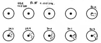

Conditions this morning were light breeze with moderate humidity at mid morning, the "flags" were a best guess of the ticker so some of the horizontal may be an errant wind read, but it was only maybe 3-5mph at the most with 105's at 100.
I shot some PPC beforehand when the conditions were thicker air and a shifty 4mph breeze, and it really showed on target. 200yds was double the fun :-X, but I am not that unhappy with the 6BR performance as far as conditions go.
I loaded several options to have a look at behaviour and these were the results.
There is the possibility that this is not simply a tuning issue. There are flyers on that target that could be mechanical in nature. Are you 100% sure the bedding in the rifle is good? That can be checked with a dial indicator. Have you checked your loaded round runout? I assume you are using some sort of bushing resizing die. Not all sizing bushings are straight. I have a box with probably 35 or 40 bushings (those that are not currently in use) that are known good bushings. I also have a box with 5 or 6 bushings that the hole is not concentric with the OD of the bushing. One cannot assume that they are correct. Either of these issues will generate groups like you have.

Go to our website To the INFORMATION tab on the home page and click "TECH TALK" in the drop down. You want to read "VLDs Making them shoot" and "Setting up your load for optimum accuracy". You may have to start over your load testing again and follow a more structured process changing one thing at a time to get the results you want. You are compromising the BC slightly with your twist rate but it should not be much of an issue. I shoot our 105 VLD target bullets out to 1000 yards with a 1-8" twist barrel with no issues except myself. Please feel free to contact us either here or at tech.support@bergerbullets.com for help if you have any questions. Thanks for using our bullets!
