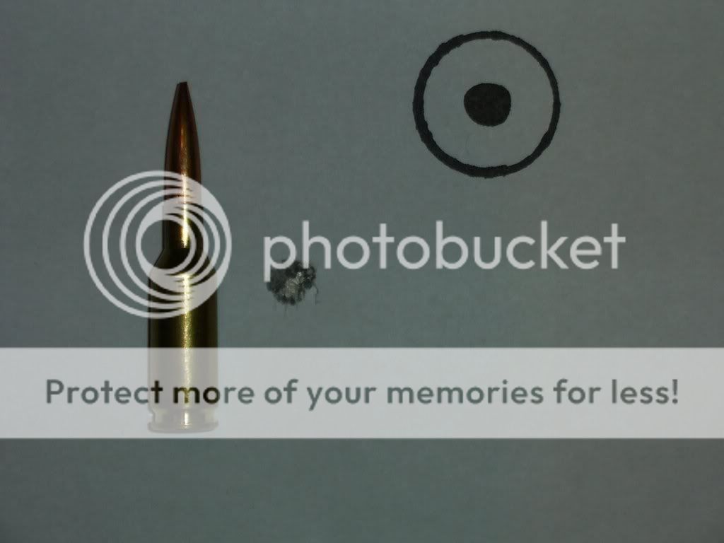

29.8grns of varget with 107 SMK's make iddy biddy tiny holes for me. But I am using the federal primers. Just start at 28.0 grns of varget and work up to 30.0 grns, you'll hit your load without much effort. As always watch for pressure signs...
PS - Just about ever target rifle I have owned operate there best 10 thou off the lands...
5 SHOTS WITH THIS LOAD W/ OUT OF BOX SAVAGE F-CLASS 6BR
