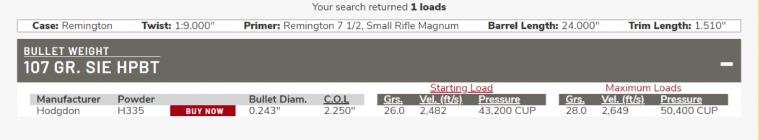

6BR & H335
I checked my Berger manual. Nothing for H335 listed for those bullet weights. The Hodgdon site shows some loads that are close, but H335 has a very narrow charge weight "window" for those loads. My guess is that Its not the best choice.
PopCharlie
It works. I don't recall what I was loading, but suspect I used the Hodgdon data, and likely towards the middle of the range. Accuracy was not outstanding, but wasn't horrible, either. I think I used it with 105 Hybrids, and 95 SMK's.
