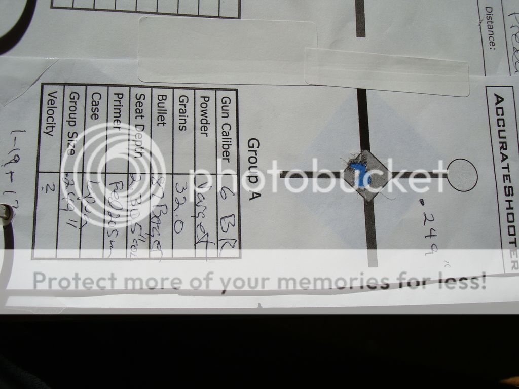

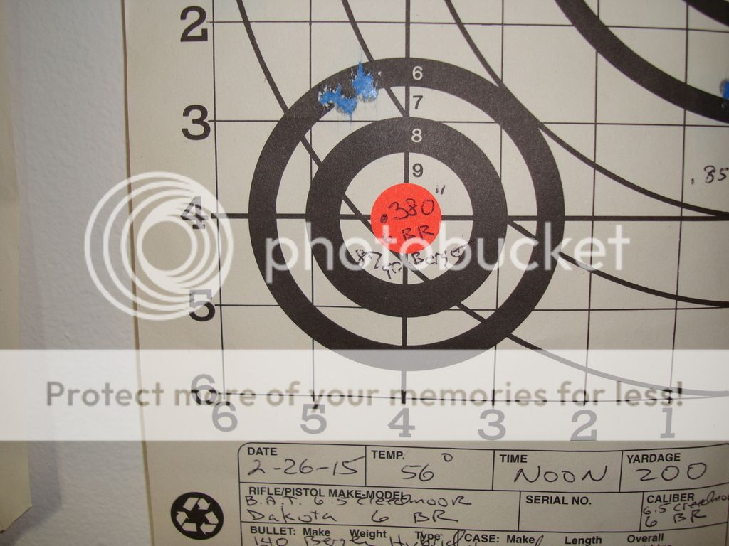

Dan, do you mind giving us your load and seating for the 87 gr Berger in the 1-10 twist barrel?
Re: 6br freebore question modified weight for the Varget!!
Sorry guys I've been busy elsewhere. The load data for the 87 Gr VLD in my 1-10 twist Dakota barrel is 32.0 Gr Varget with the bullet seated about 20/1000s ( square mark ) into the rifling and 205M primer. I got the load off this sight from MarkS. Here are some groups the rifle shot with this load.
The first group is at 200 yards and the second one is 100 yards. Both 5 shots out of the Dakota Predator seen in the previous posts. This load shoots well in all the 6BR's I've tried it in with no pressure signs. TRY IT.
