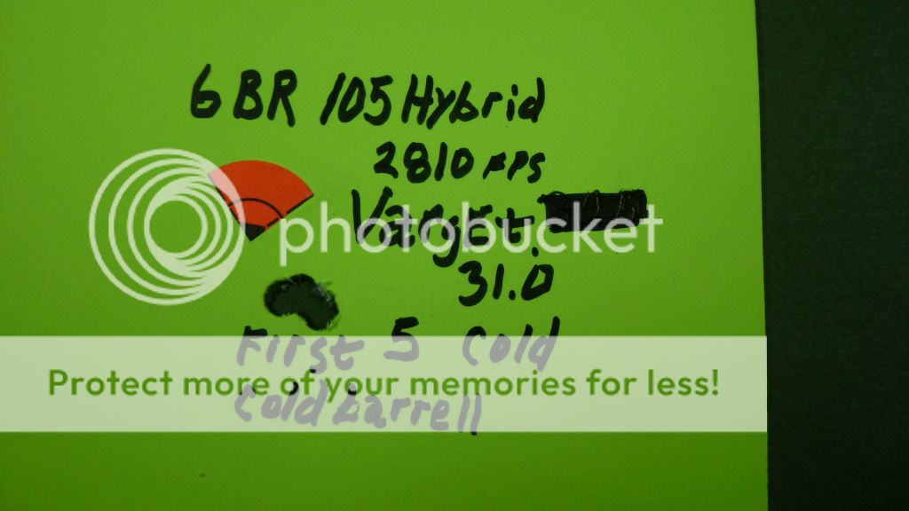

Five shots at 100 yd
I shot the 105 Hybrids out to 700 yds. today and they seem to be
flatter than the 115's.
I used my Dasher chart for the elevation come up's from 100 yd zero to
700 yds. The chart is set for a Dasher 115 Bergers at 2900 ft per second.
My hybrids from my 6 BR had a muzzle velocity of 2810 fps.
My chart said to dial up 15 MOA for 700 yds. and the little hybrid hit
about 4 inches high. Berger's BC claim for the hybrid must be true.
I hope to try it at 1,000 tomorrow.

My 6 br Hybrid was 2810 fps.
My Dasher 115 is 2900 fps.
In this situation the Hybrid is the slower round.
but it shot as flat as the faster 115.
