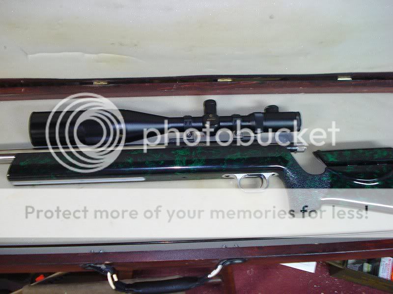

HPMike 800,multiple guns) Yes i do have multiple guns. I've just finished a 6 PPC, I'm still fireforming new brass.
I currently shoot a 6BR, 30" BARRELL 1-8" TW built off of a Remington XR 100. I'm throwing 105 Lapua's,was using 107 smk's) down the range at around 2900 fps. The ballistics match the rifle my buddy is just building now a 6.5x47.
The XC LARGER BULLETS,115/111's @ 3000-3100fps) are a match according to the math and the software to the 6.5x284 shooting the 142 gr scenars.
But, 1 I would like to be different from the local crowd, I understand the canadian b.c. boys are all shooting BR's.
And 2 I don't want a barrell burner
And 3 I thought it might be cool having 3 6mm rifles.
As for 1000 yd accuracy Last weekend I shot the lt.gov.'s match here in Ontario. On the one match,1000yd) after the 2 siters I had 10 Bullseyes, the problem is only 5 of them were "V" bulls and I ended up in 8th.
I want the other 5 back next year and 1st place. If I don't win I want it to be my fault. I'd like the 6.5 performance with out smoking barrells.
I was just looking here for confirmation from someone that's used one that it could be a plausable upgrade from the exhisting BR I have now.
I'll probably still used the BR from 300-800 and keep the round count down on the 900-1000 yd gun.
Pic one 6PPC
Pic 2 6BR,now with nightforce)
And as for being the big dog, this is a picture of my son with my PGW 50 BMG
Mike.
Mike, I like your taste in stocks - I've got a couple of Ian & Kelly's H&H stocks in that same Vermont Granite color pattern, and enjoy the comments I get on them.
The first H&H is on a BAT 3L with a 30" 7.5-twist .236" bore Krieger chambered for 6x47 Lapua, and I love the way this rifle handles the 115s,Berger & DTAC). This was my 2nd 6x47 - the 1st was built around a short 700 with a Bartlein .237" bore 8-twist in a McMillan A5. The Bartlein is 100fps faster than the Krieger with 115s - logic would lead one to expect that, what with the tighter bore & faster twist of the Krieger, and I wasn't the least surprised that it turned out that way. I will order .237" bores on future Kriegers. I've worked up to 3095fps with moly'd DTAC 115s & RL17 in the Bartlein so far, and have yet to see pressure signs, so may well get closer to the 3200+fps German Salazar got with his 6XC. That makes the 6x47 a contender at 1000, just as it would a 6XC. If the conditions are such that I feel under-gunned with the 6x47, I'll shoot a straight 284W with Berger or JLK 180s - I expect to be able to get upwards of 2900fps with the 180s using RL17, and that's going to beat the best of the 6.5x284s in the wind.
