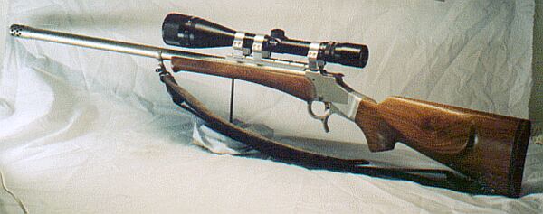

Here's a story on an EABCO model 97D in 6PPC.
http://www.6mmbr.com/gunweek022.html
You'll find some load info with 58 and 65gr V-Max, N135.
