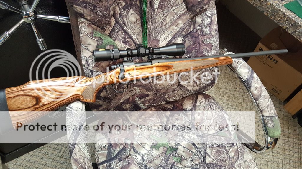

This is the 700 LS that we are starting with.

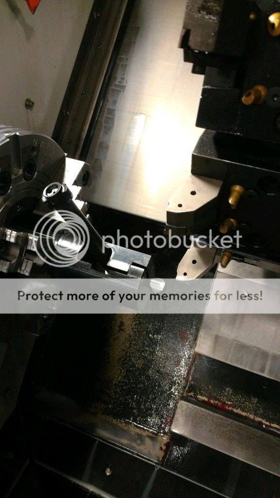

Here is the new barrel and the stock receiver that has been removed so it can be "squared up"

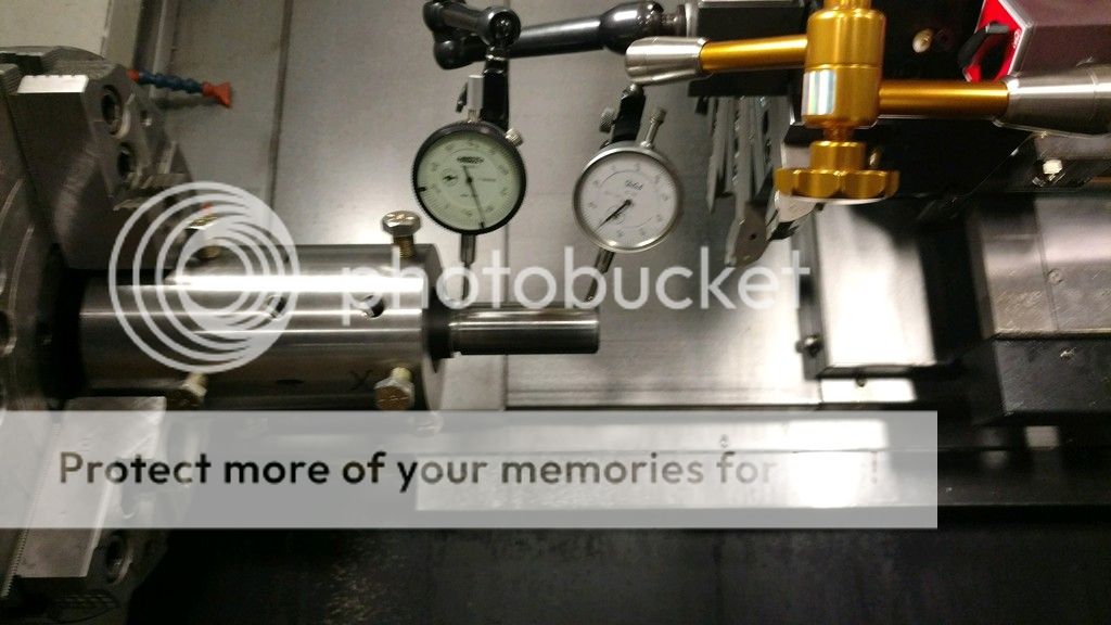

This photo with the dial indicators is setting up to recut the thread to the new centerline of the bolt raceway. They cut the lugs and square the receiver face in the same setup.

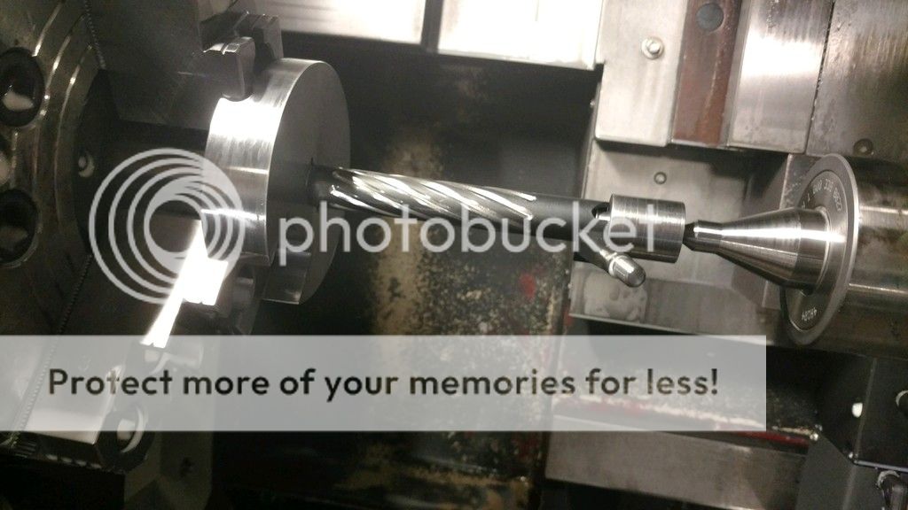

This photo is the setup to thread the bolt handle.
