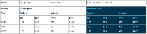

6 Dasher or 6BRX ?
Yea, I think it may be hard to find much data for either one. I just have some and wanted to see how it would perform in the 6BRX
I have one guy that I can think of that has tried it in 6BR with the TSX bullet, and I think I recall he started with data from VV. In my experience, a Dasher or BRX would have roughly the same or have some margin against an identical recipe from 6BR.
I can ask him how his gun compared to the VV data.
He came to me for help when the TSX didn't group well and I advised him to try a larger jump. That worked for him, but I didn't catch the details on how the N150 tracked versus the VV load data.
Anyone have load data with VV-N150 for any bullet weight ?
