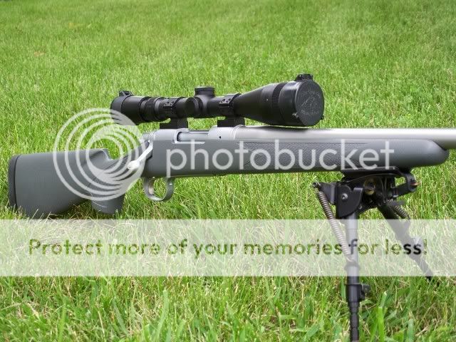

I've put together several 22 and 6 Dasher, all on 700's, all fed fine with no magazine alterations. I found them to feed best when treated like a 30-30 lever, no dilly dallying working the bolt, and life is good. I would never put up with a coyote gun that didn't feed.....
22 Dasher:
22 Dasher:
22 Dasher:
6 Dasher:
6 Dasher:
6 Dasher:
6 Dasher:
