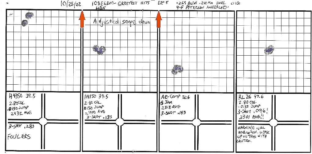

You must have missed the post's that Hornady bullets are junk.
I know I know. Look at these terrible 108 ELD-M groups from yesterday with three different powders. ;)
