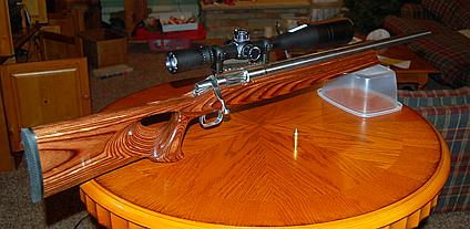

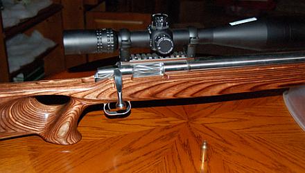

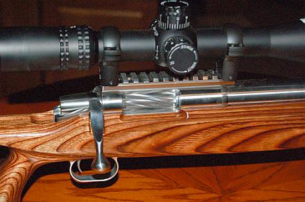

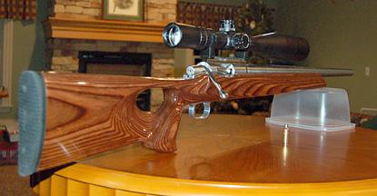

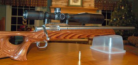

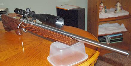

I have 100 fireformed cases from my recent Richards Custom Rifle built 6 brx i could send you a few
here are some pics:
GGT--
Nice looking rifle!
