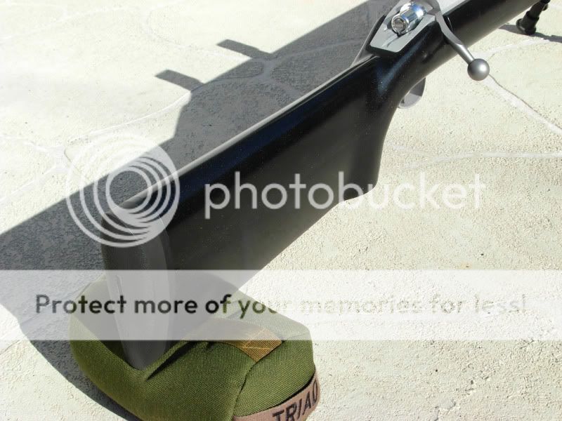

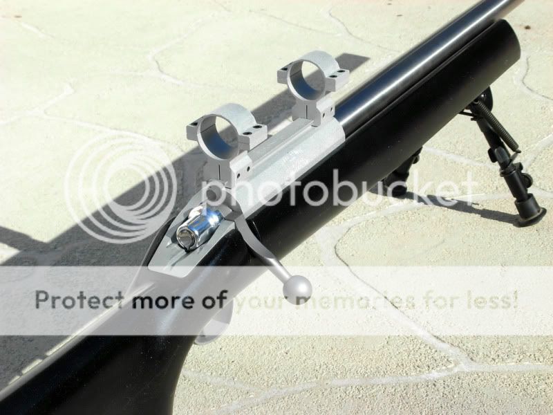

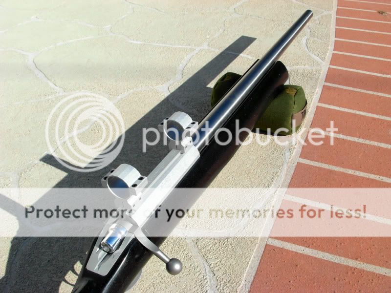

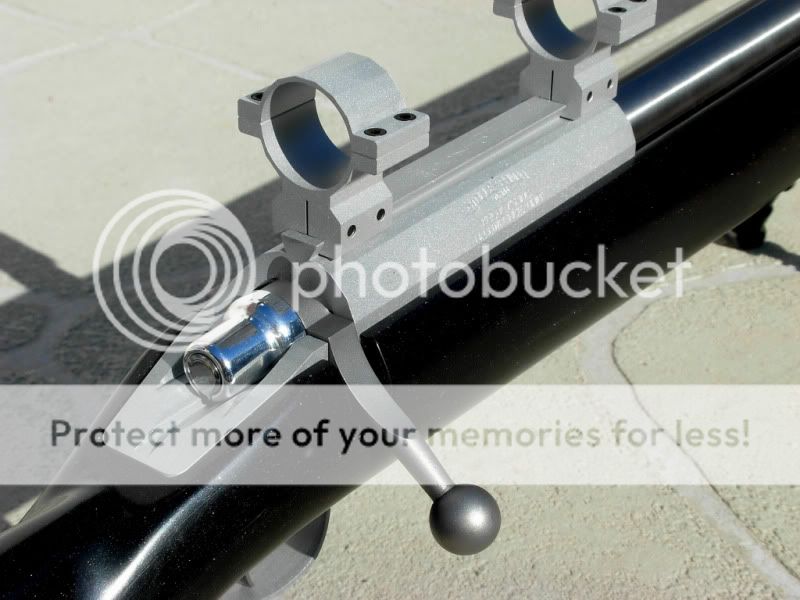

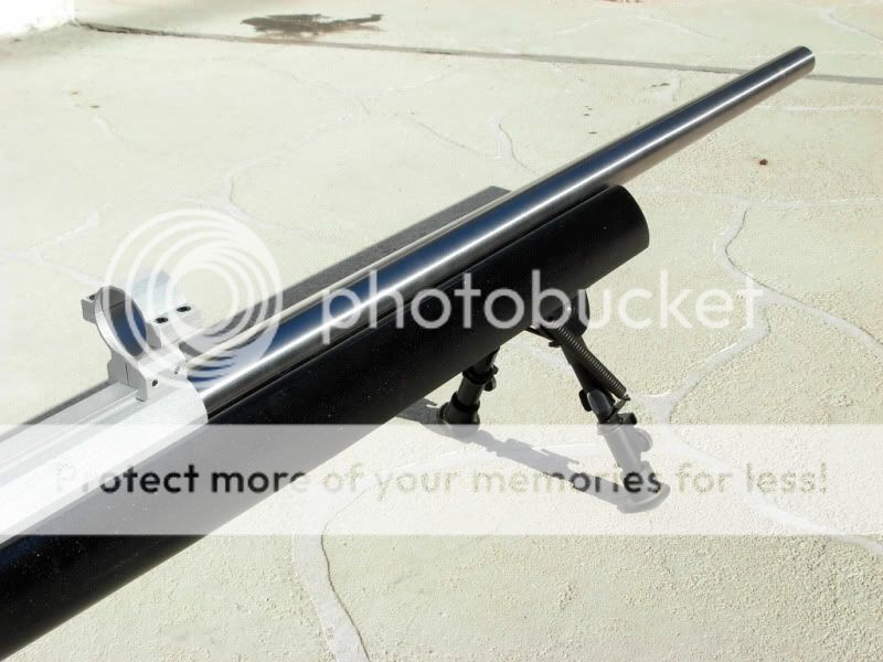

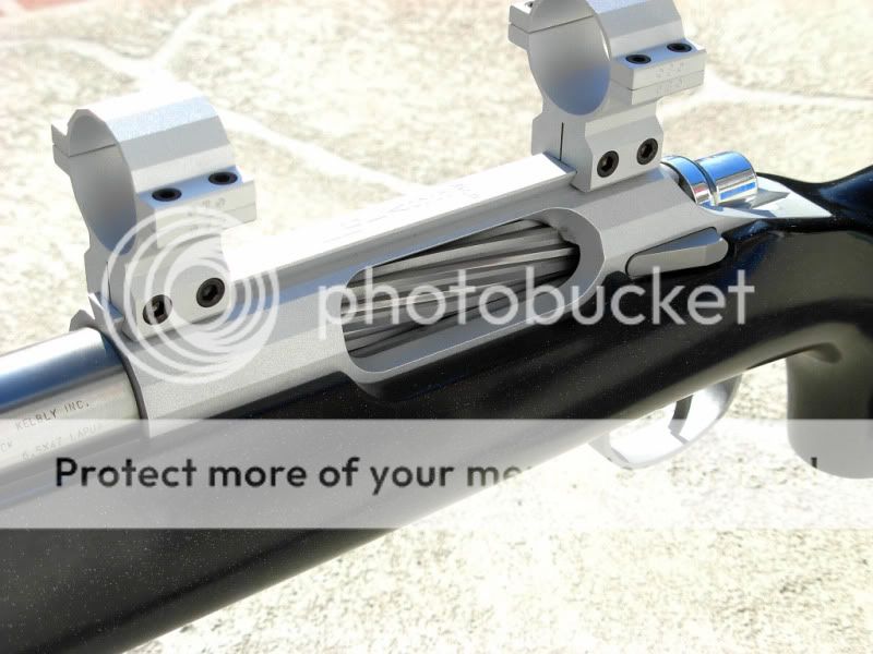

Just picked up a Kelby Panda with a Krieger barrel.
It has a .297 neck on it. What size bushing will I need to purchase? Will be using Lapua brass and Wilson dies.

F Class Panda R-L, Krieger 1-8'' twist, 6.5 x 47 .297 neck, Kelby 1M stock black with silver flakes, Jewell Trigger.
