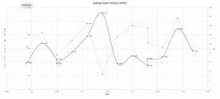

The far right of the graph, 2.132 represents .004 into the lands while the far left, 2.105, represents .023 off the lands. The blue line is MOA at 100 yards while the red line is SD. So as you look from left to right the seating depth is getting closer to the lands. While high .4s are nothing to crow about, this was better than the previous best .5s and it looks like a stable node. The graph seems to indicate that testing both deeper into the lands and further out than .023 off might yield better results though, I'd rather not jam unless I have to. Below is the result of further testing:

I did confirm that 2.123 which is .005 off the lands does shoot okay but, whatever is going on at 2.105 or .023 off the lands does not seem like it is in a very forgiving node. Maybe testing even further off the lands will yield better results.

I'd try different bullets and speeds. My best results have been between 2770 and 2810 with all the bullets/barrels. I could get to 2870 with 140s but it didn't shoot as well as it did slower. Although I use a chronograph, I have found that getting caught up in ES/SDs can be a distraction. I don't pay too much attention until the end and even then, if the target looks great then I don't care. My wife's 6.5x47 put three shots into 0.625" at 1k the last time she took it out and two hit the center of the "X". That load has higher ES than I would like but I am not changing it!
I would also look at more jump. I start at 30k and work out. My wife's current load is jumping about 70k. In my experience, the nodes farther out are usually wider and more stable than the ones in close.
I also note that your SD's bounce around for what should be very similar conditions (only the seating depth varies by 0.003" and all else is the same). I may be wrong but that tells me your data set is too small to get a meaningful SD.
