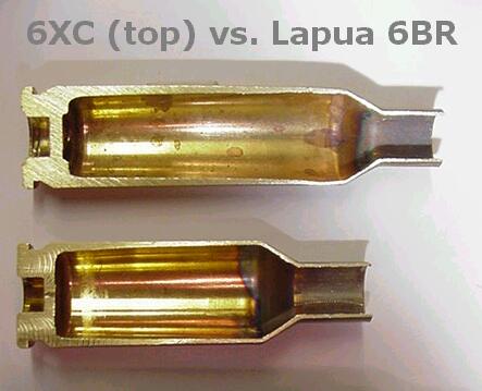

That they can use the same tooling used to make .308 Winchester? This tooling is also used for 6BR, .243, 7-08 and a host of other "inaccurate" or "weak" cartridges. Or maybe it's because most accurate rifles use extractors optimized for the .308 case? The rim on .308 dimension cases is thicker, permitting higher extraction forces.
Besides, strength of a cartridge case is only partially a matter of its external configuration. Thickness of the case in the head and web matters, but thickness variations can also result from dimensional differences INSIDE the case. As seen from the picture below,from the 6XC page of this site - see http://www.6mmbr.com/6XC.html ), the extractor groove cut is located well below the web of the case. Note both casings have identical external dimensions in the case head and web areas, but the 6XC has thicker walls.
