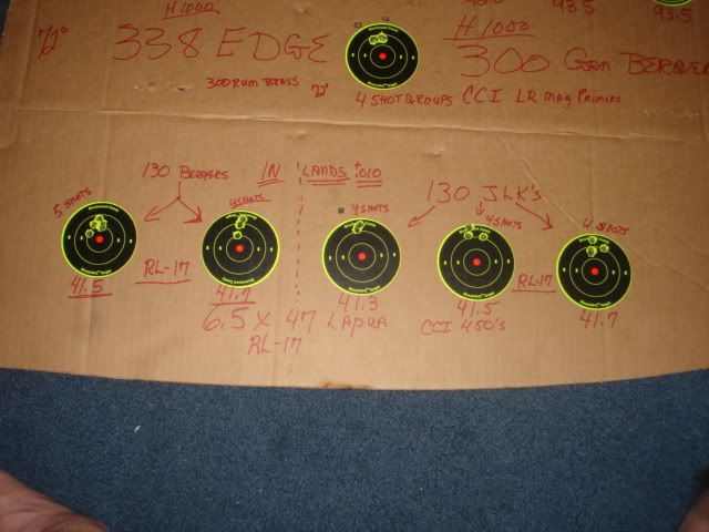

Eric, thank's for taking the time and helping me! After shooting 130's yesterday and RL17, looks like Lapua 123's are going to be the bullet for my gun.
UNLESS the 139's changes the above statement!!!!!!!!
It's nothing to be proud of, but below is my results with the RL17, H4350 and Varget still produce the better groups!
I might load a few with a lower charge, it may tighten the two groups of the left side of the picture! But I am not going to try too hard until I get the 139's!
