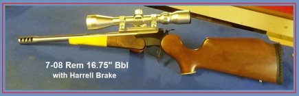

I shoot the 7-08 Rem. Easy to load for and versatile from varmints to big game
