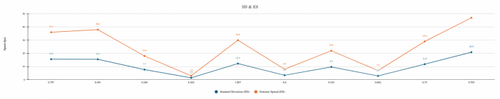

Hey all, was hoping you fine folks could help me take a look at some range data. To this point I've loaded a shot a whole bunch of rounds of different bullet/powder combos, and want to start fine-tuning what I have. For whatever reason, the next steps of load development eludes me, even after watching numerous videos and reading as much as I can on it. I've put too much emphasis on group size, but I know that velocity matters more, and groups can be adjusted based on seating depth. I'm a hands-on learner, and think that it'll click once I get some feedback on rounds that I've actually loaded and put downrange, as opposed to looking at numbers and charts of other people's data.
Below is the data for one of the reloads, based on your thoughts I'll extrapolate that to my other loads. Any guidance would be much appreciated, thanks in advance!
140gr Berger Hybrid Target

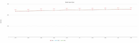

Grain Powder (gr)37.838.138.438.739.039.339.639.940.240.540.841.1
Shot #
Group In0.834"0.514"0.259"0.444"1.054"0.628"0.173"0.630"0.785"0.738"0.819"0.895"
Group MOA0.7970.4910.2480.4241.0070.60.1650.6020.750.7050.7830.855
Shot 1236423772397241524462466248424902528250725692556
Shot 2233523392415241824762460246524852513250125592574
Shot 32328236024112460245824622492249925482545
Sum702770767223483373827384741174677540755676735130
Mean:2342.32358.72407.72416.52460.72461.32470.32489.02513.32518.72557.72565.0
Median:2335.02360.02411.02416.52460.02460.02465.02490.02513.02507.02559.02565.0
Min:2328.02339.02397.02415.02446.02458.02462.02485.02499.02501.02545.02556.0
Max:2364.02377.02415.02418.02476.02466.02484.02492.02528.02548.02569.02574.0
Shot ##N/A#N/A#N/A#N/A#N/A#N/A#N/A#N/A#N/A#N/A#N/A#N/A
Standard Deviation (SD):15.615.57.71.512.33.49.72.911.820.99.89.0
Extreme Spread (ES):36.038.018.03.030.08.022.07.029.047.024.018.0
What is it you’re aiming to do with this rifle? For anything sub 600m, especially hunting, you’ve already got a few good loads that you can do some seating depth variations on if you think you need better ES /SD. For longer ranges, your existing loads could also work, but you’re handicapped by the 20” bbl length there.
It is mostly going to be sub-600, with the occasional longer distances. Probably not going to be hunting with this one though. Which loads would you choose to further tune, if you had to? Seems to me that 39.6, 39.9, 40.8 & 41.1 all did pretty well based off velocity, ES & SD?
Honestly - if you're going to stick to 99% sub 600, then your load is already there - 39.6 - what more do you want at 0.173" groups? Load more of them, shoot some 5 shot groups and see if it holds up. Then close the books, and shoot....
