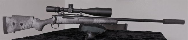

I wanna play.
@WSMNUT spun this up for me, took it out for the 1st time today.
Rem700 trued, 27" Brux rem varmint contour 6.5-284 Norma
I planned on painting before shooting this, but like a kid at Christmas I had to take a peek.
If you want a quick turn around call Zack!
If you want accuracy definitely call Zack!
He built 2 rifles for me and shipped back in a month.
Got my zero @48gr h4350 WLRPM 136scenar L's.
Ran a chronograph report on shots 8-12
Shots 13-30 looking for charge weight to begin seating depth test. Probably going to load 49.2gr here.
Shot @200 yards due to a match on upper range.
I'll be playing with the creedmoor next but I'm definitely painting it 1st while I fine tune this rifle. Then I'm tearing it down for some apple red candy paint.
