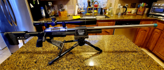

I got first the 6mmCrdM and then built at home my 6.5 PRC with 30" barrel, a Bench/Prone rifle.
The 6.5 PRC is capable of hits at 1500 yards or more.
It is a monster of a rifle at 1000 yards. I can launch a 145-147gr bullet at close to 3100 fps from a 30" tube
