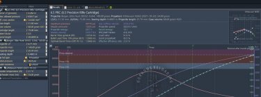

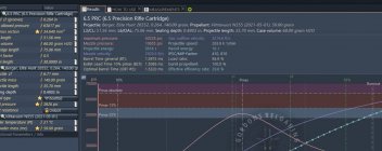

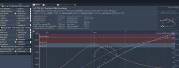

6.5 PRC "30 powder choice
I just run the numbers in GRT for a prospective 6.5PRC build. Assuming target velocity of 2920fps
Interesting! I tried N165 and N565 with 147 & 150 grain bullet. Both worked good, but I preferred the n565 loads. Try them both and see what the barrel says! N165 should run cooler than the N5XX series. Bill
