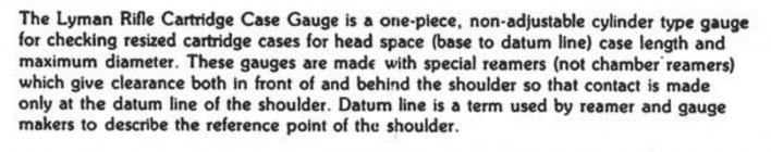

So I ordered a Lyman gauge in 6.5 and figured I'd just add it as a step. Well upon spot checking some of the rounds I loaded up this week. They actually 'fail' the case gauge and remain proud of the gauge a little bit.

Case gauges may, or may not, be dimensionally the same as the chamber. Gauges sold commercially are likely made to represent the smallest chamber dimensions. Not surprising that the chamber in your barrel is slightly larger…
From Wilson's webpage for their case gauge:
"measure min/max headspace and min/max case length on fired cases. Ideal for trimming and safe shoulder sizing."​
=> if a case is proud to the gauge, it exceeds the max SAAMI dimension.
Reactions: K22
^^^^ this plus, I believe, if memory serves me correctly, that the sizing end of the gauge has a .005" difference between the upper and lower step. The idea is to size the case, so it fits approximately in the middle of the step. However, this applies only to chambers cut to SAAMI specs.
If you have a chamber cut to different dimensions a bump gauge and caliber will assist you in set up your die by measuring the fire case (primer removed) and setting you die to size it to the optimal fit for your rifle chamber.
While gauge like the Wilson can be used as a qualitative check for cases shot in SAMMI spec chambers, the bump gauge and caliper measurements are more precise for setting up your sizing die.
